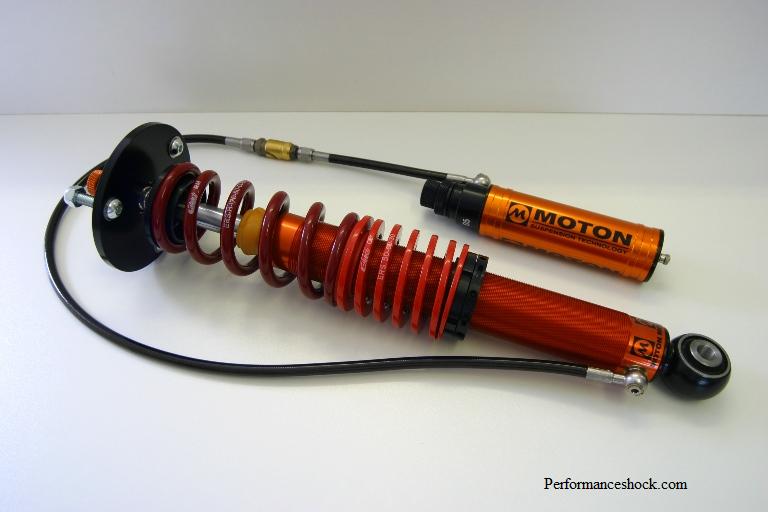

The term 'piggyback' describes the positioning of the bump cannister. Historically MOTON had always used a 'remote reservoir' which was connected to the damper by a hose.
This lead to complications when the installation was on a road car, where it was a preference of the client that the car could be returned to standard at a later date, or they did not wish for further modifications.
In some instances the remote reservoir are more desirable, certainly for adjustment on a race car, without the need to lift the car for adjustment, but for this particular product, customer demand for a 'piggyback' no further modifications solution, has lead to this development.
Just to summarise, the standard damper is removed from the car, and the new MOTON damper is fitted in place, no other modifications to the car are required for fitment.

Piggyback as in the remote reservoir is attached to the main damper body like this...
attachment.php
as opposed to connected via a hose...

Scott, thanks for posting the pictures, it clearly defines the two different types..
