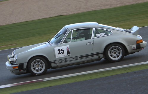

a couple of action shots from the race at Croft during Tour Britannia, the pictures don't show too well but it was fairly wet !

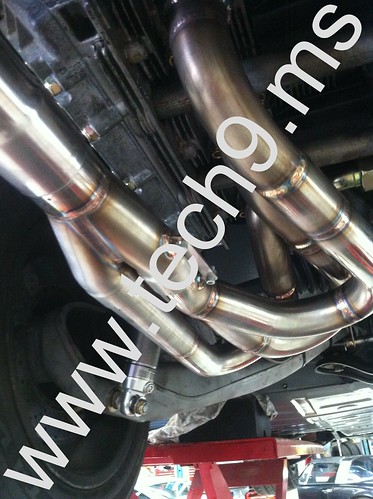

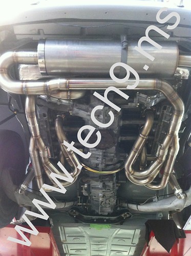

I considered various options available for an exhaust for the SCR.
The brief was to achieve maximum mid-range torque, less than 105dB, a repackable final silencer and lightweight.
This layout is not strictly in accordance with the homolgation documents so for FIA events we have a system in reserve, but this system will be used for all other events and track-days etc.
The design was considered and we opted for a stepped primary header, equal length (design optimised), a three into one merge collector, then a two into one merge into a final silencer.
This system was hand fabricated in-house, we plan to produce a jig for future supply
We acheived our goals, this was the system that I ran in the Tour Britannia event, it was tested at 102dB and we recently had the car on the dyno and we acheived a good 20bhp increase over the previous system we had on the car (RSR style headers with a 2 in 2 out silencer).
It would be interesting to try this system in place of a standard road system, we do plan this for the future, but as yet its not done. I am certain the gains will be substantial.
Here are a couple of pictures showing the detail

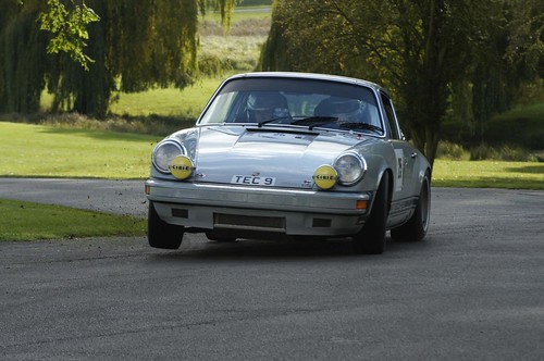

Taken yesterday during the Mini Britannia event, this was a great stage that ran in the grounds of Packington Hall, near Coventry

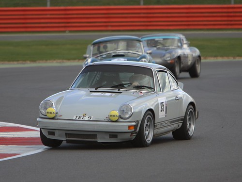

a couple more from the race we had as part of the Mini Britannia event, Silverstone International circuit - thanks Shimmy the data you provided was very useful, am running 7000rpm shift and was pulling 6900rpm at the braking point for Stowe with the ratios we fitted :thumbup::thumbsup2:
