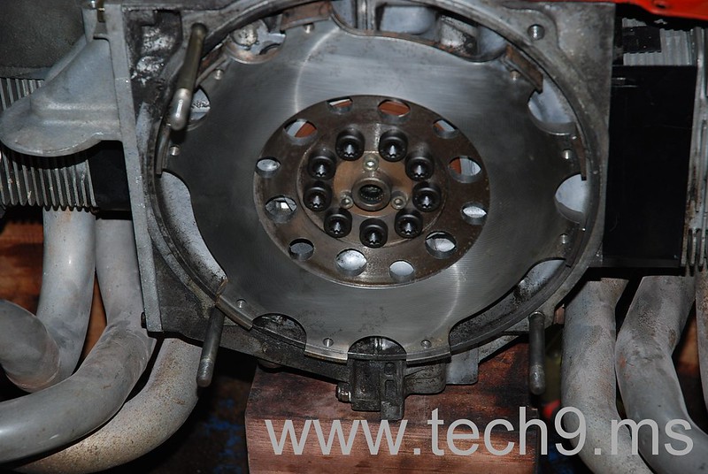

getting ready to install the engine and gearbox, a few detail shots to share - lightweight flywheel (2475g vs 4464g standard) installed using ARP bolts

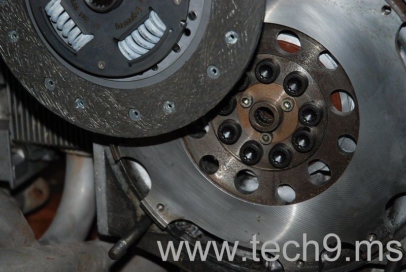

Installing a Sachs power clutch (weight 4474g)

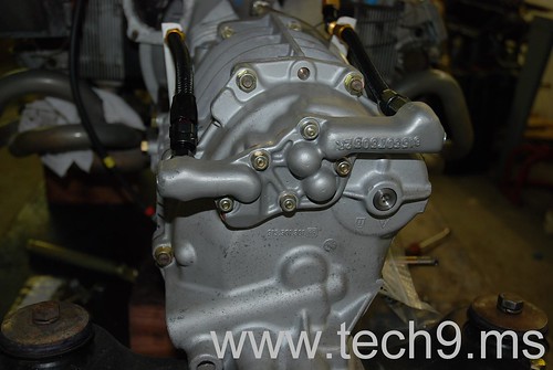

Quick shot of the RSR gearbox oil cooling pump

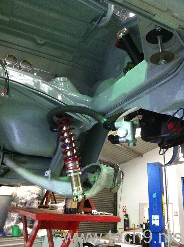

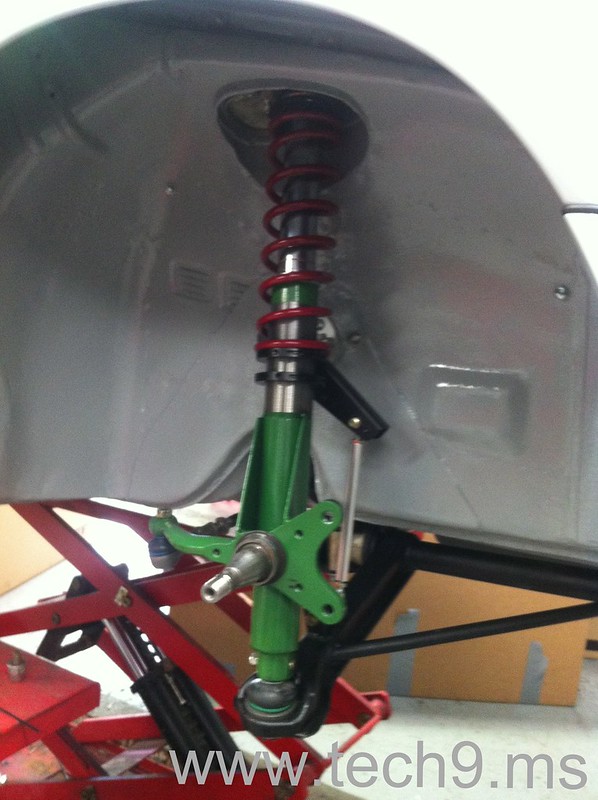

At last we are able to install the dampers, these are a new development from Ohlins, and these are the very first set into the UK. Its been frustrating to wait four months whilst production of these has been completed but hopefully will be well worth the wait. The dampers are single adjustable, just under 30 positions, so should cater for road/track driving and change of conditions - can't wait to test them, not too long now !
Rear dampers installed
Front dampers
