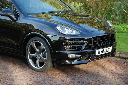

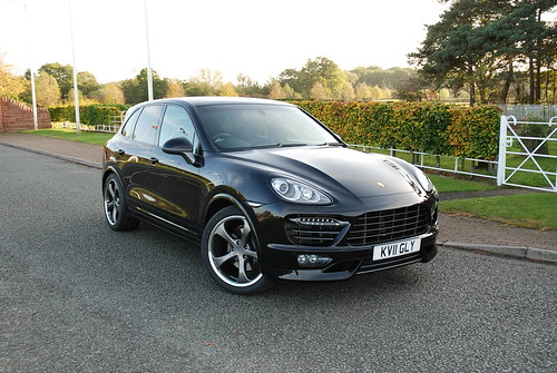

Cayenne Diesel with Turbo-look and TECHART Aerokit I
We recently completed the following conversion to a Cayenne Diesel. We replaced the front bumper and bonnet with the parts from a Cayenne Turbo.
As part of the TECHART Aerokit I upgrade, we fitted twin fog/spot lamps in the lower section of the bumper, and added the TECHART multi-function DRL unit (black optic)

we fitted a turbo bonnet too, as its higher profile than the standard part, then integrates with the profile lines in the bumper
its about £3.5k inc VAT fitted and painted, the turbo-look conversion - for comparison
Did you paint the wheel arch lips ? The body shop I use wasn't keen on doing this because of the textured finish.
yes, these are the extended arch option, they have a textured finish as standard, we prepare them smooth, then paint them body colour, also the lower trims on the doors. Makes a big visual difference on the car, its probably not as obvious on a black car, as it is on a light colour like white

£3.5k for the complete conversion using bonnet and front bumper using all genuine Porsche parts, fitted painted and the wiring configured to accept the Turbo DRL units.
Please note, the car pictured aside from the Turbo-Look,also has TECHART DRL's, twin lamp conversion and the Front Spoiler I, plus all the grilles have been painted and colour coded a contrast grey. All these parts are extra costs, the £3.5k gets you a standard turbo-look
