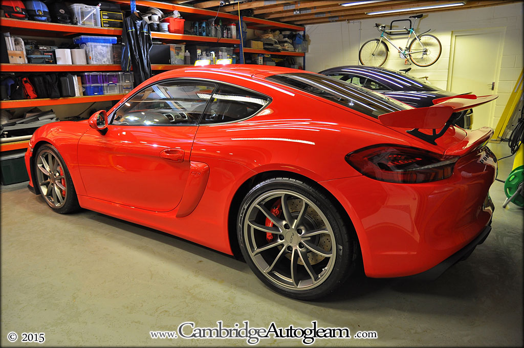

The main job I wanted to show was this brand new Guards Red Porsche Cayman GT4. The customer asked the supplying dealer NOT to carry out any prep on the car what so ever. This would hopefully minimise the potential for marking the non metallic paint.
Unfortunately once washed and put under the lights in the garage there were still a number of defects that needed correcting.

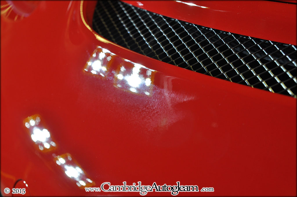

Swirls on the bonnet

In fact we ended up polishing every panel. Some just required a single stage with a finishing polish but some areas, especially the bumper, required heavy cutting to remove the deeper scratches and / or sanding marks..

After all that polishing the paint was finally perfect, which it should have been already seeing as the car was picked up, driven home, and left in the garage and not touched until our arrival. All the panels were wiped down with Spies Hecker 7010 Panel wipe / Silicon remover and checked after each polishing stage. This removes all oils and silicon that can be left from the polishing stage and which can mask very faint swirls. This way we can ensure we really are removing the marks and not just covering them up.

The finished car..
