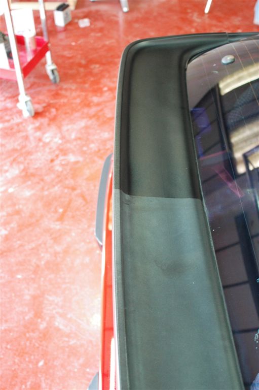

C4 was applied to the unpainted plastics. Although C4 has excellent restorative properties... it also protects new plastics to stop them fading in the first place
Image showing how it restores faded trim.
