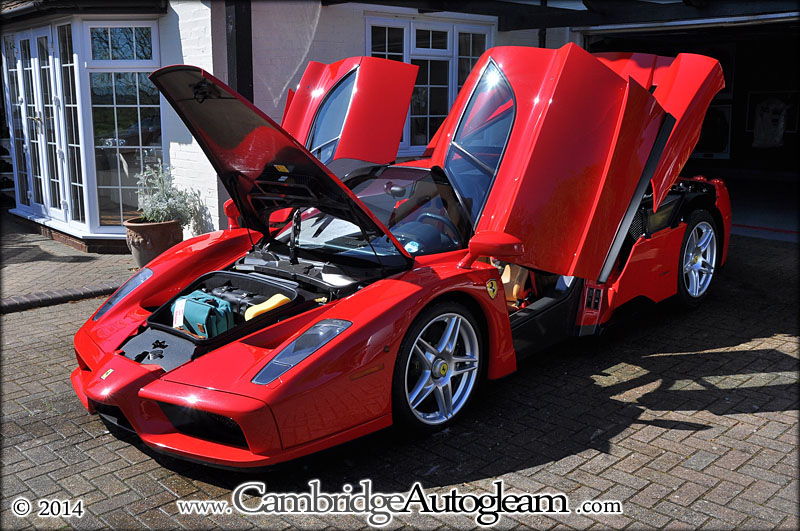

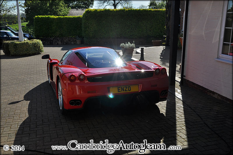

We arrived at 7:45am (having left home at 6am) to be greeted with a rather wonderful sight. (and yes that is the plate it drives around on )
This particular Enzo is one of the original UK cars and has been owned from new by this customer. Its covered around 18000 miles in 10 years which is fairly high for a car of this type. Its usual aesthetic maintenance consists of being dry dusted even after a short drive and an occasional Autoglym super resin hand polish so it was well due a bit of pampering.

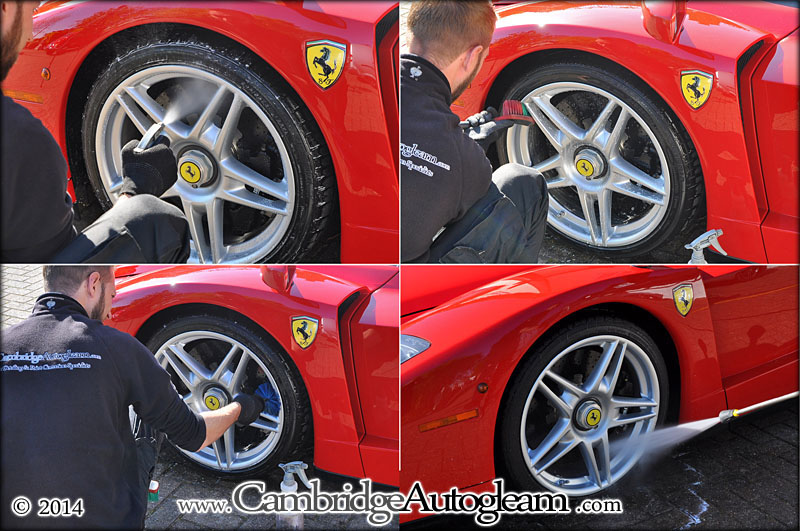

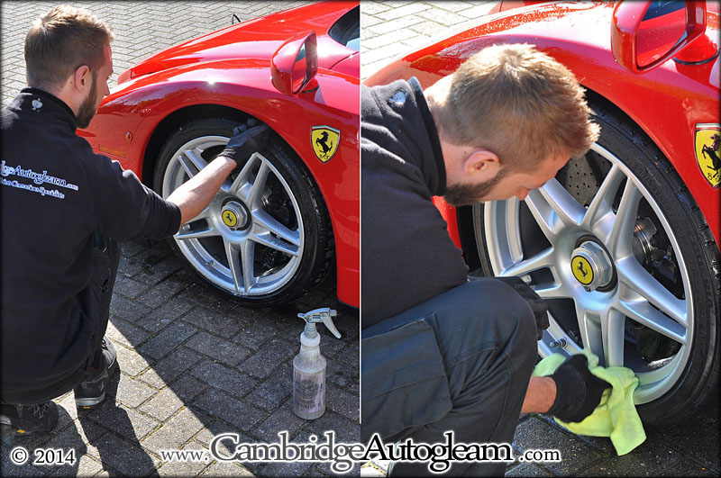

As usual I started off with the wheels. The tyres, wheel face and barrel was soaked with Autoglym Custom Wheel Cleaner. I still find this an excellent product for getting road grim and old dressings off the tyres and its perfectly safe to use regularly without discolouring brake components while still giving enough cleaning power to easily clean mild brake dust build up.
The arches were sprayed with All Purpose Cleaner and rinsed and then the arch and wheel were sprayed with Autoglym tar and glue remover and dissolved tar spots were wiped off with a microfibre towel.
I did try Autofinesse Iron out on the wheels but there was zero contamination so nothing to really photograph.

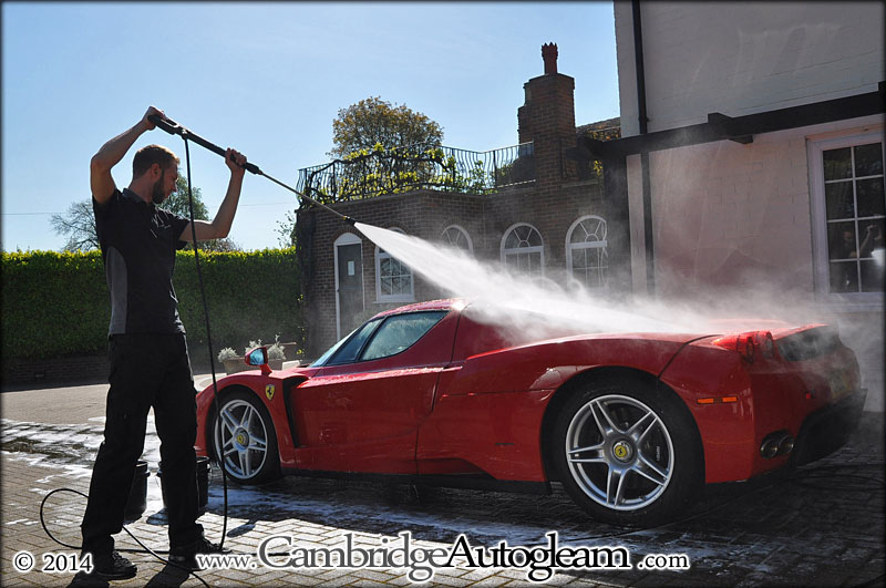

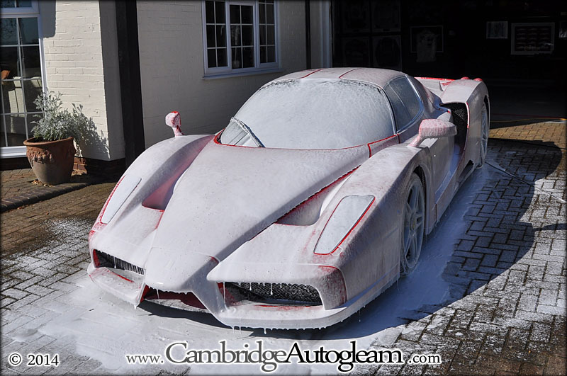

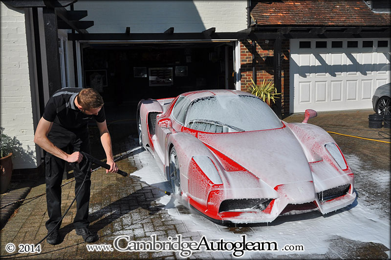

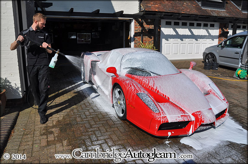

The car was then covered with foam to start softening any dirt and to start help strip any protection / fillers from the paint.
.. and after a few minutes this was rinsed off. Remember at this point you are washing the dirt off, not just the foam, so work slowly and methodically coving all of the car.

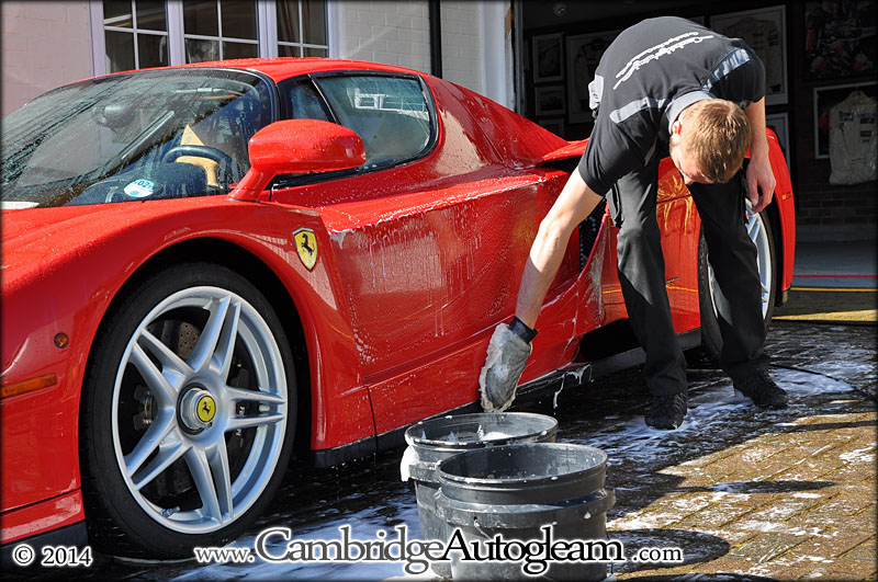

Then it was shampooed with Auto Finesse lather and a two bucket method (one bucket with clean soapy water and one to agitate your mitt in once you have cleaned a section before picking up new clean shampoo... for those that don't know)
At this stage I also covered the lower panels with tar remover and then iron out and neither showed any signs of contamination so It was rinsed again and dried down ready for polishing.

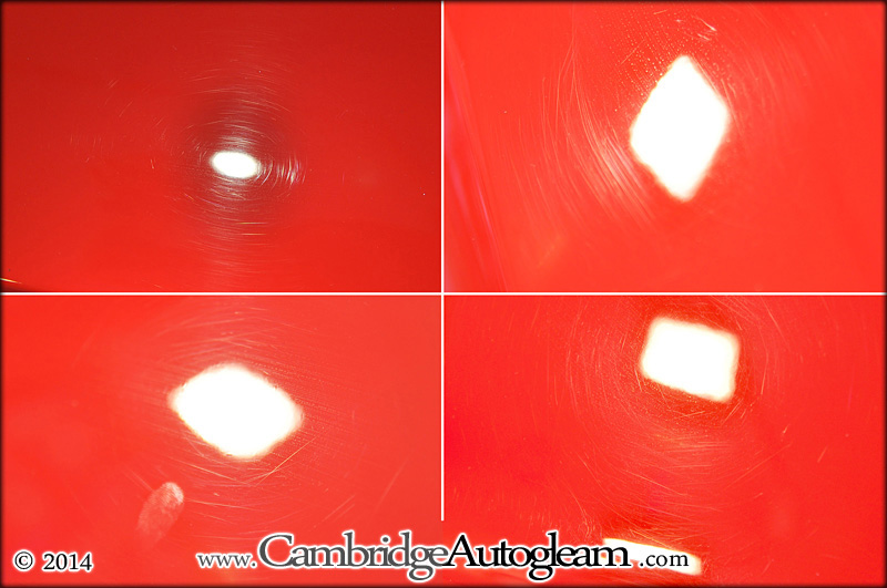

Now.. red isn't the easiest colour to capture defects so out of the hundreds of photos I took, these were the best ones.
Not TOO bad but it can certainly be improved. Thankfully in a way the paint was extremely hard so starting with the softest combination I had and working up it took me all the way to Meguiars D300 on a Meguiars microfibre pad before any progress was made. This was then refined with Menzerna 203s on a Chemical guys hex-logic pad... and this was the result by way of a 50/50 photo
