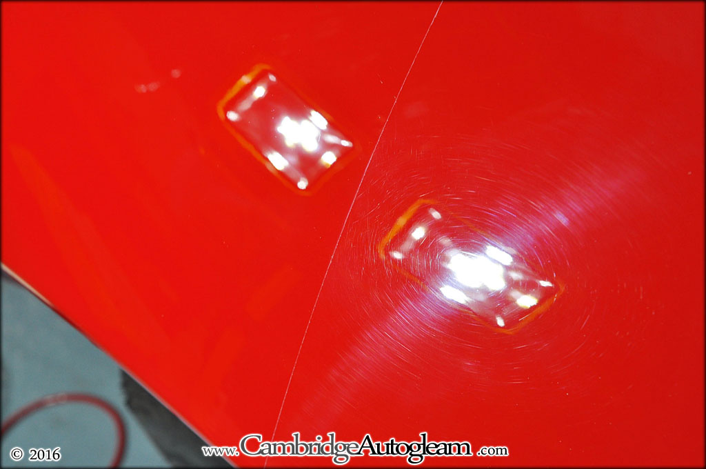

After 17 years the paint was looking a little tired. This iPhone photo shows the general state of the paint.
A 50/50 shot showing the difference paint correction can make.

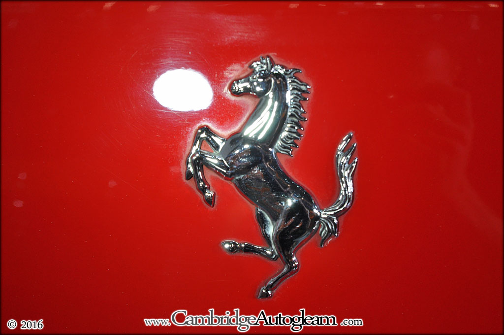

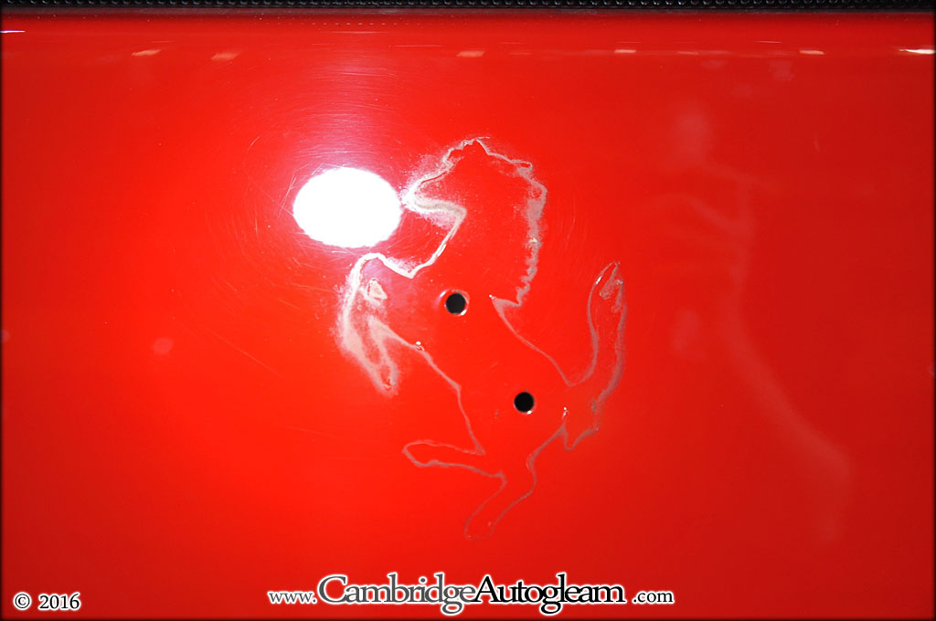

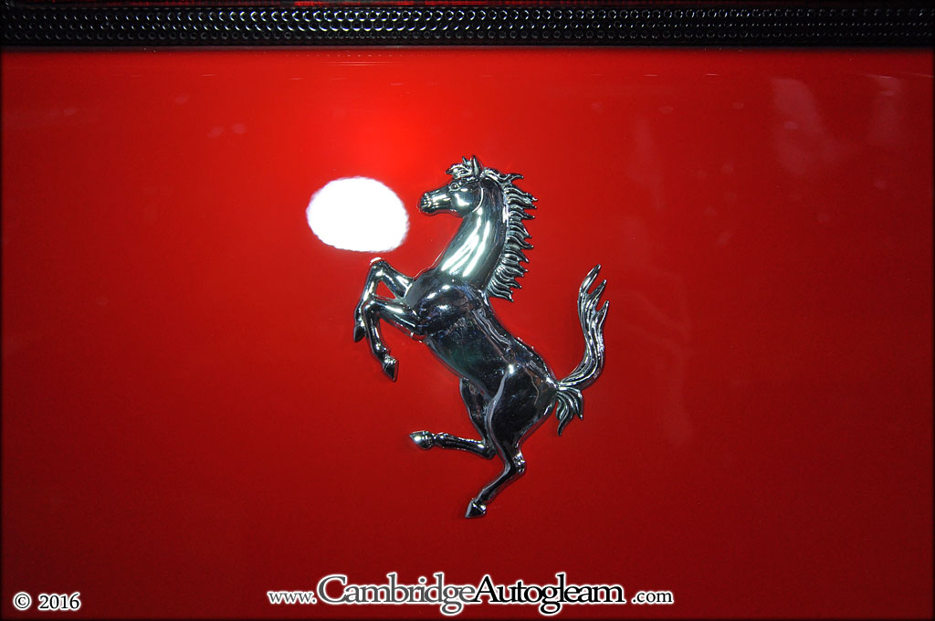

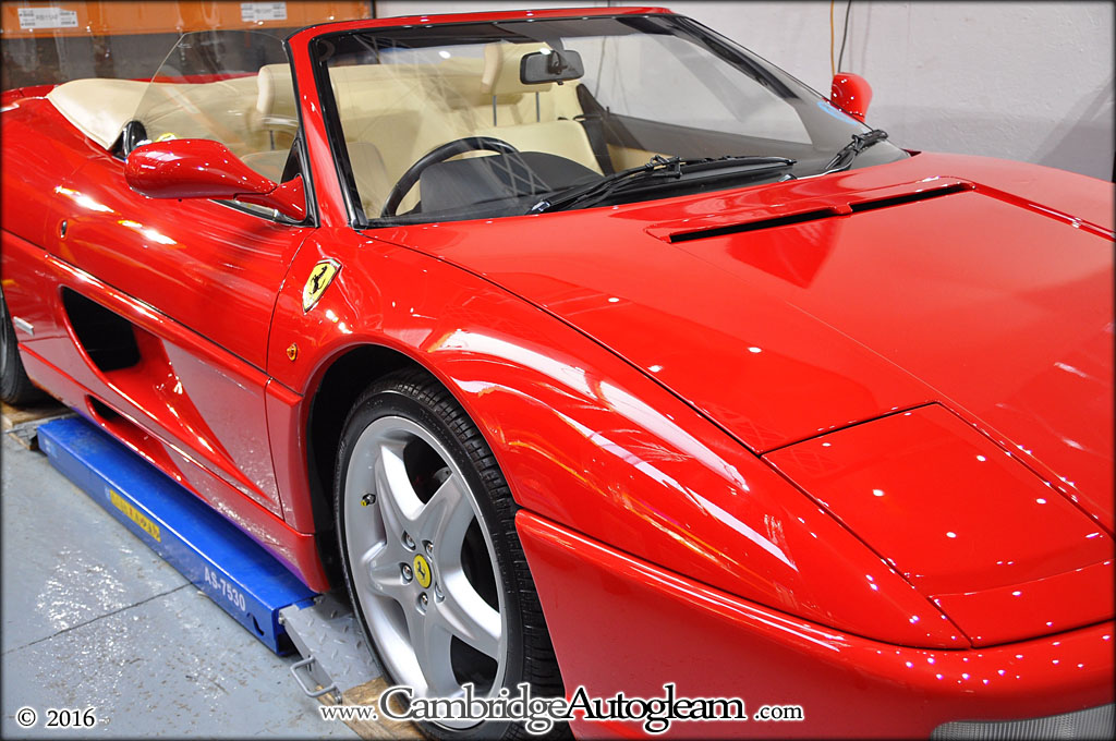

There was quite a lot of built up dirt around the prancing horse as well so that was removed so the paint behind could be polished. Little details like this make all the difference.

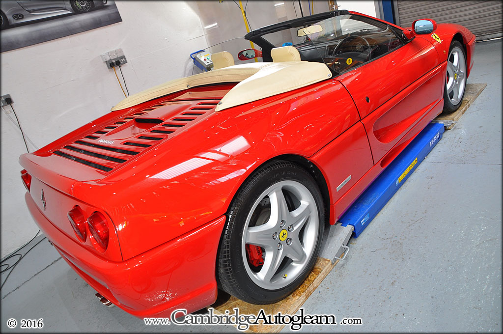

The wheels were also removed so the inner wheels could be properly cleaned, old wheel weight stickers removed and then the inner and outer wheel sealed with Gtechniq C5.

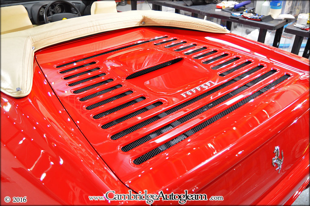

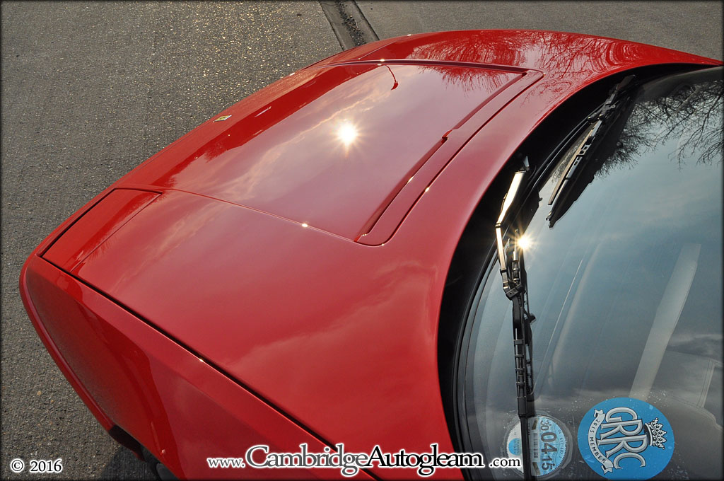

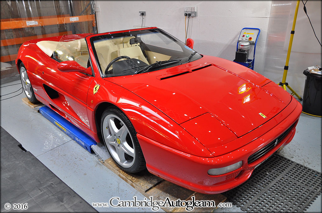

With all the polishing and cleaning complete it was time for the coatings. The fabric roof had already been treated with Gtechniq I1 at the beginning of the job. The paint was coated with Gtechniq Crystal Serum and Exo (otherwise known as CS Black). The Serum gives the long lasting protection and the Exo gives around 18 months of water and dirt repellency.

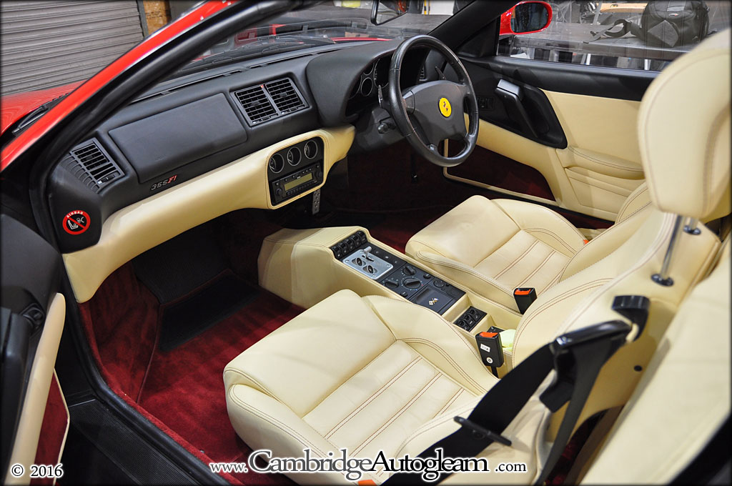

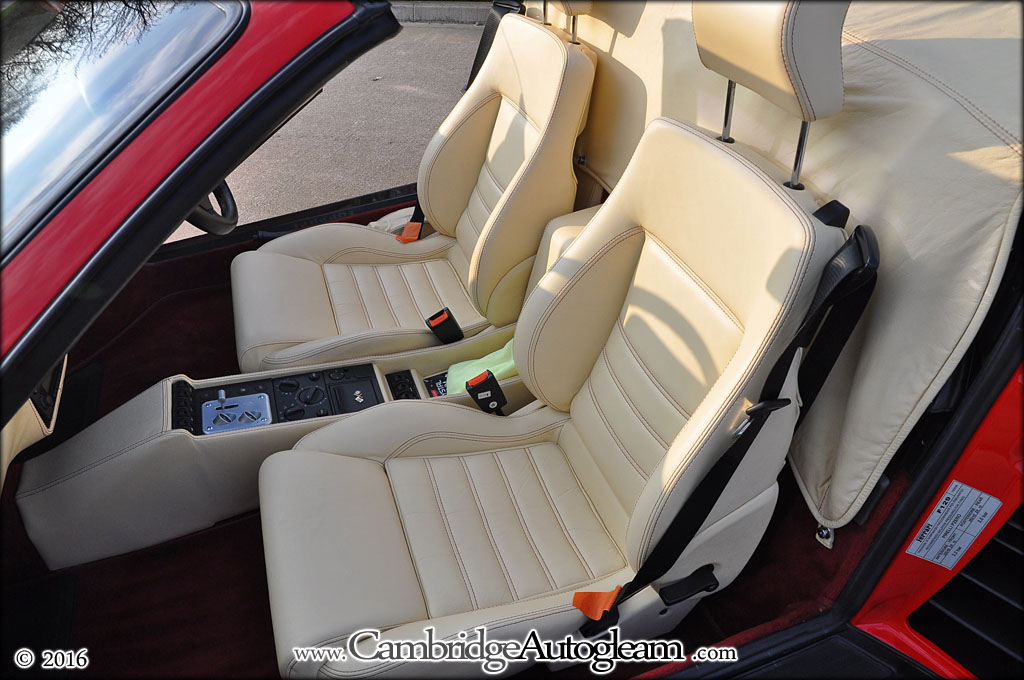

Wheels had already been coated with Gtechniq C5 and tyres with Gtechniq T1. The interior was cleaned with Gtechniq I2 and then protected with I1 on the fabrics and L1 on the leather.
A quick example of the beading of Gtechniq coatings. Change to 1080p for the best viewing
[video=youtube;caMyOg_At8k]https://youtu.be/caMyOg_At8k[/video]

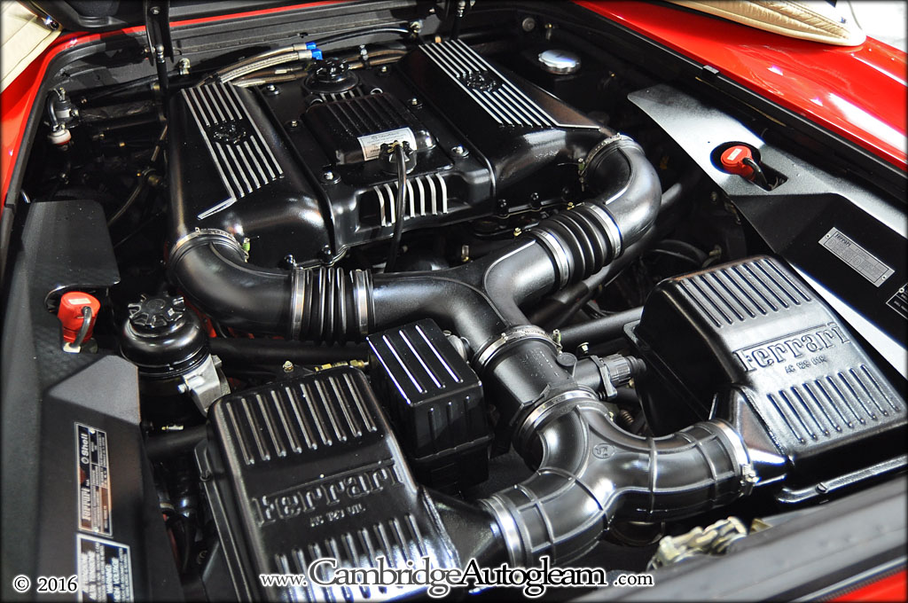

The engine bay was already in excellent condition so all it needed was some degreaser in a few localised places and then dressing with CarPro PERL.

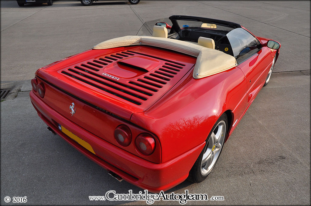

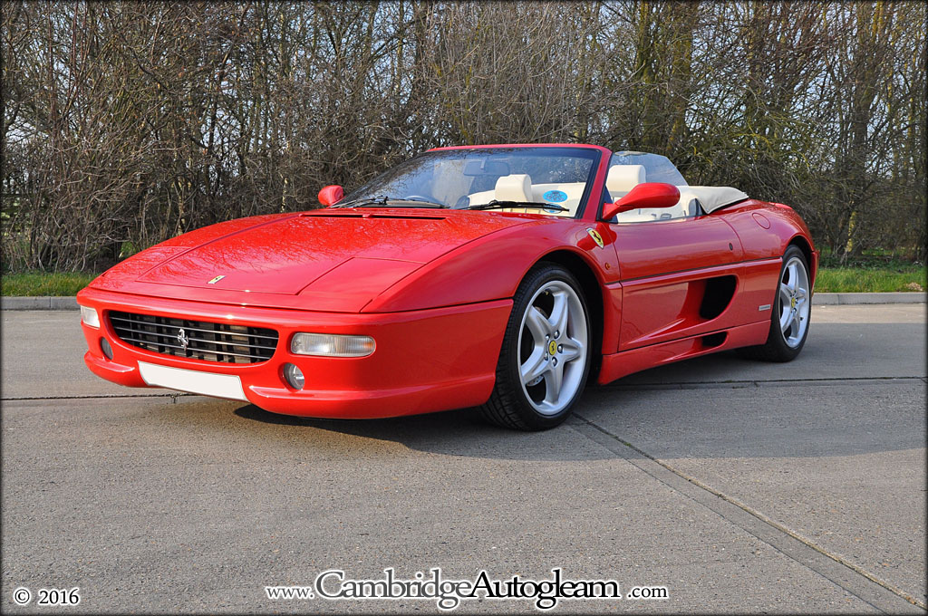

And the finished photos..

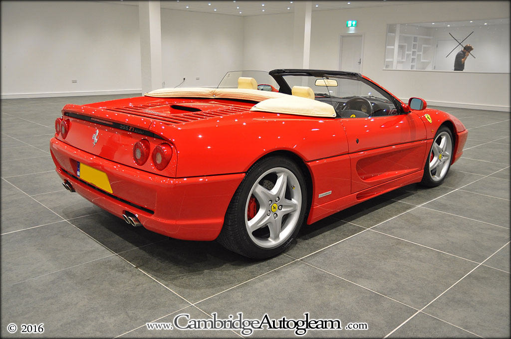

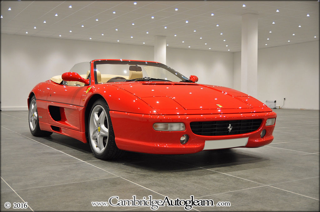

We then put the car back into Autostore's new showroom ready for the customer to collect.
