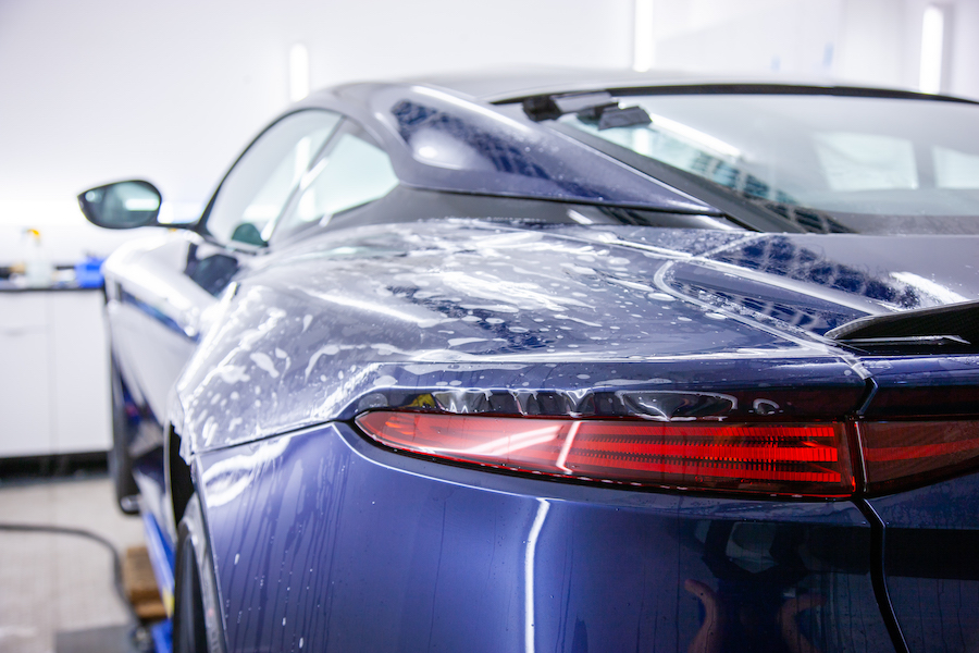

We primarily use Xpel ultimate film and our own modified Xpel templates in order to wrap a few more edges and also aid the fitment to avoid adhesive shift marks on the main panels.

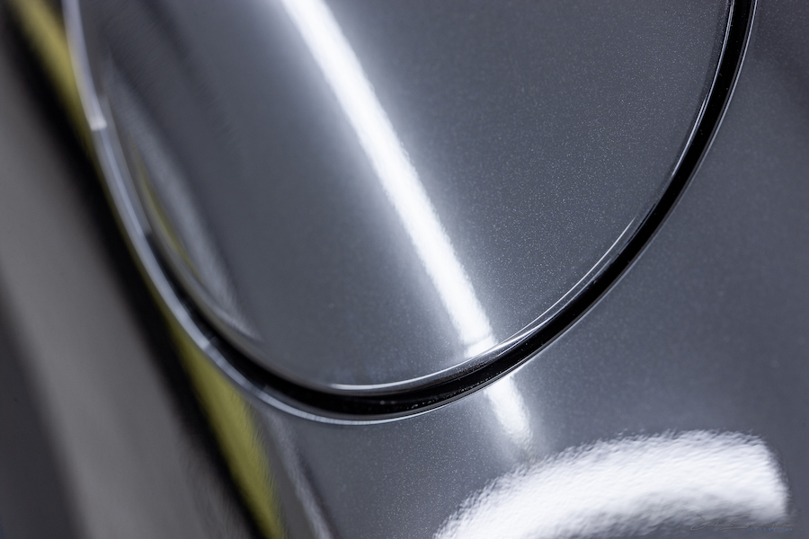

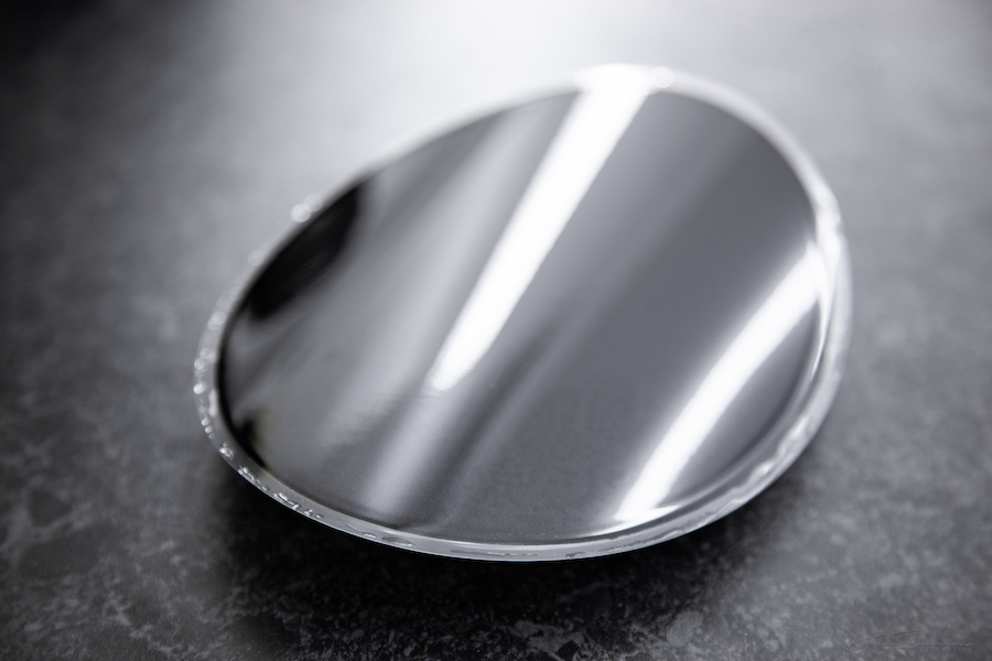

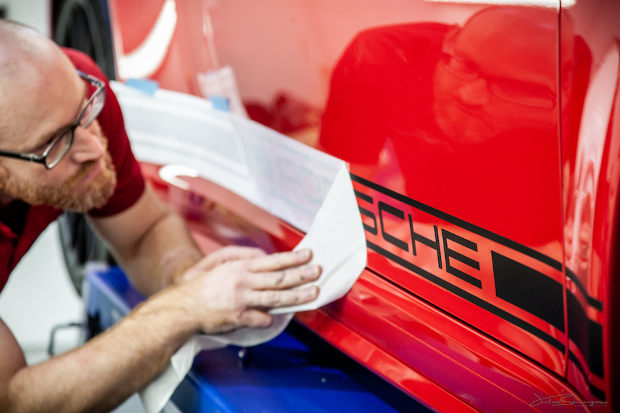

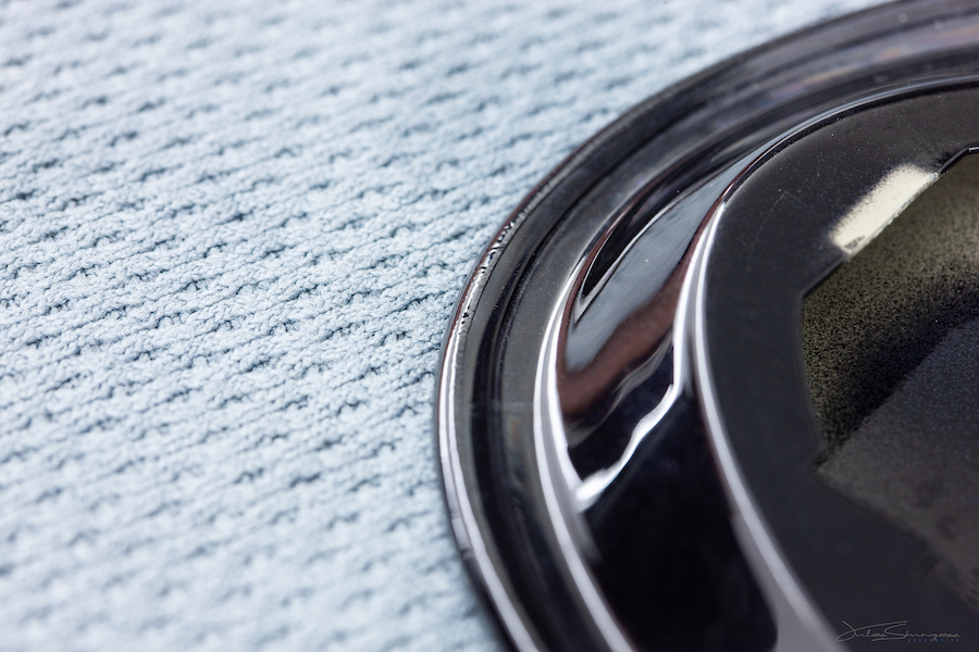

Just to breifly talk through these photos, Porsche 991 fuel cap removed and PPF applied
Excess film wrapped
Fuel cap re fitted with all edges on both the fuel cap and the wing wrapped

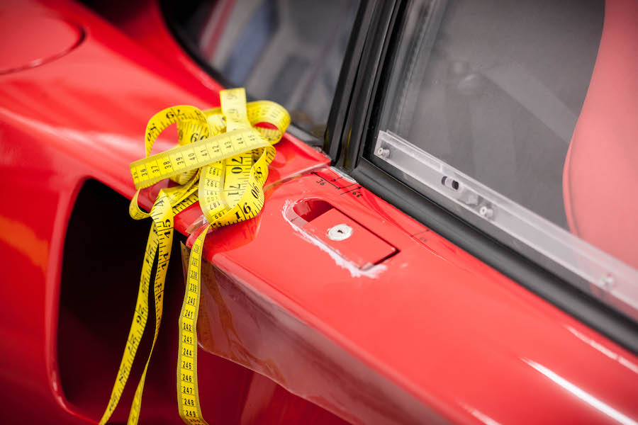

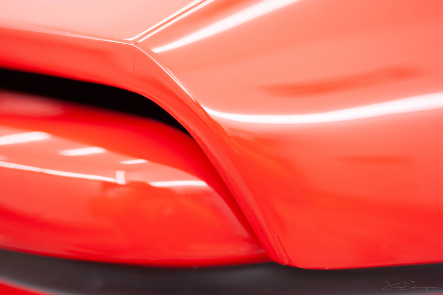

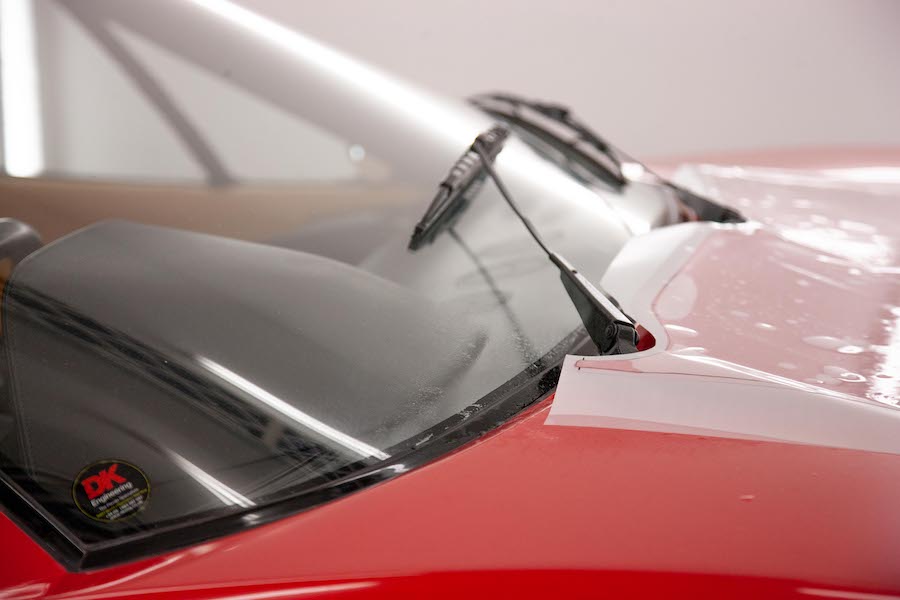

We also offer a bespoke templating service for older cars where either no templates are available, or the templates are so old or not accurate enough for the fitment we aim to achieve.

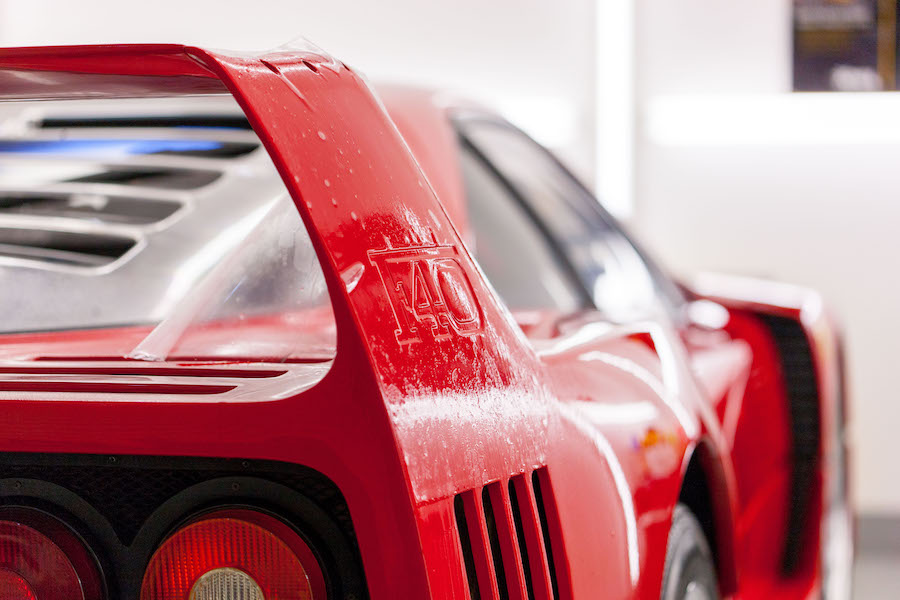

This F40 received a full wrap with bespoke templates all made with templating film in house.

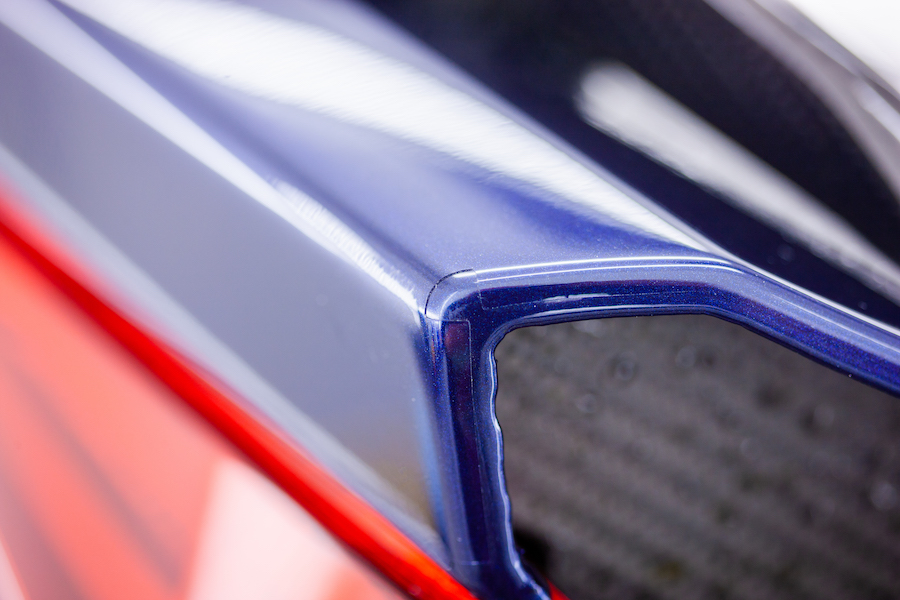

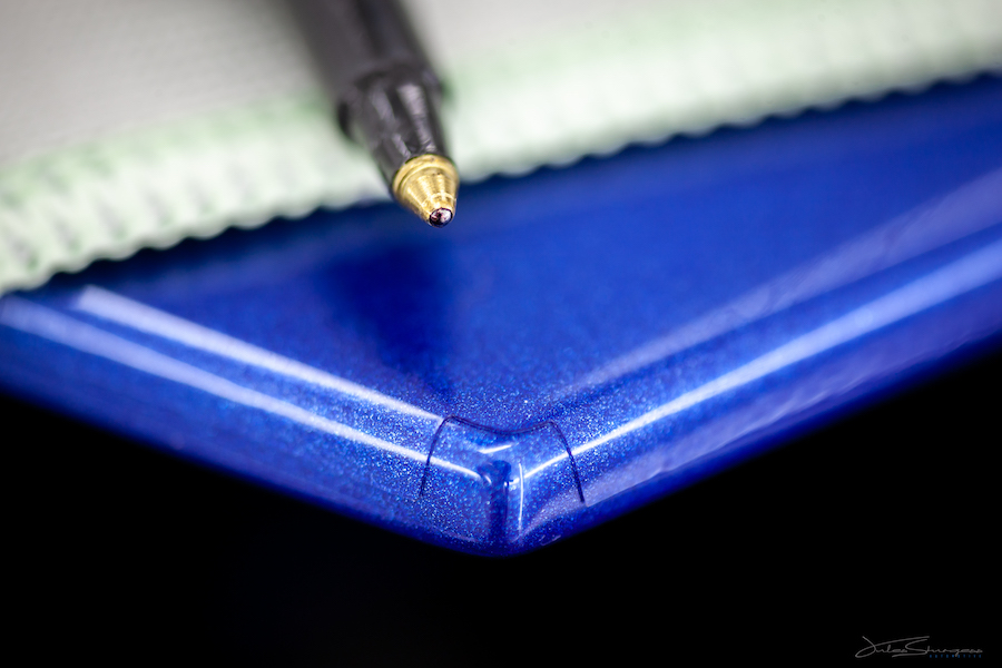

And this 328 had a front end, sill and lower door bespoke template and fitment. Look closely and you can see how the leading edges are wrapped

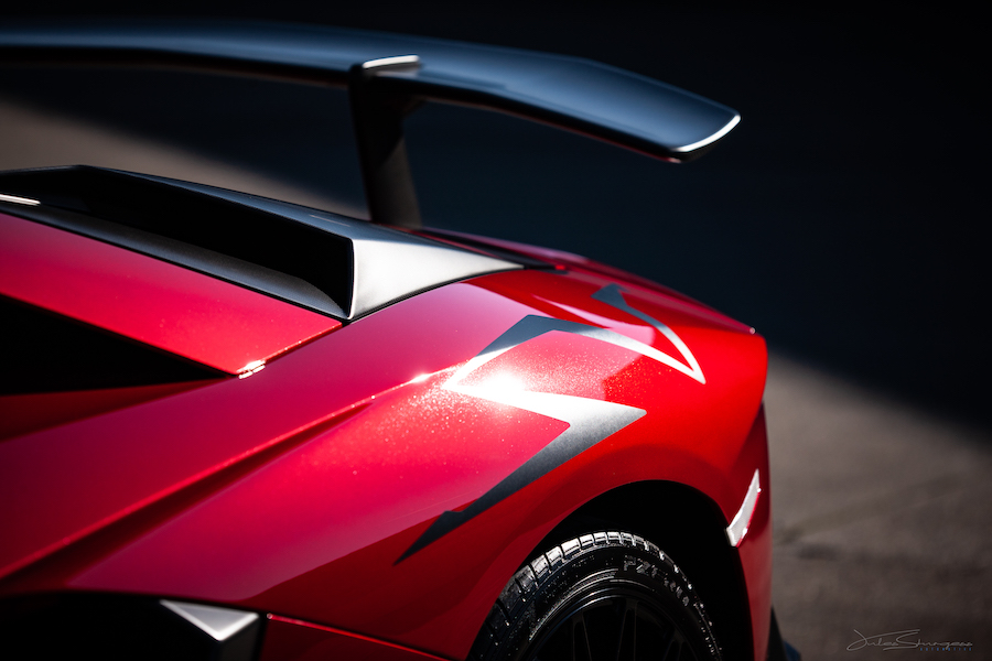

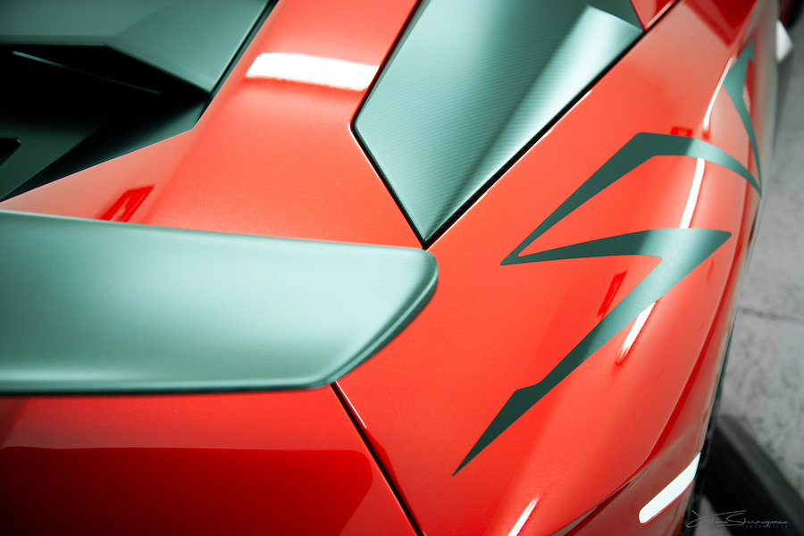

... and we also design and produce vinyl graphics in house. This Aventador SV was in for a full PPF wrap. The OEM satin SV stickers were removed to enable a seamless, bubble free PPF fitment, new SV vinyl digitally reproduced to match originals perfectly, in a matching satin finish and re fitted on top of the gloss PPF.
